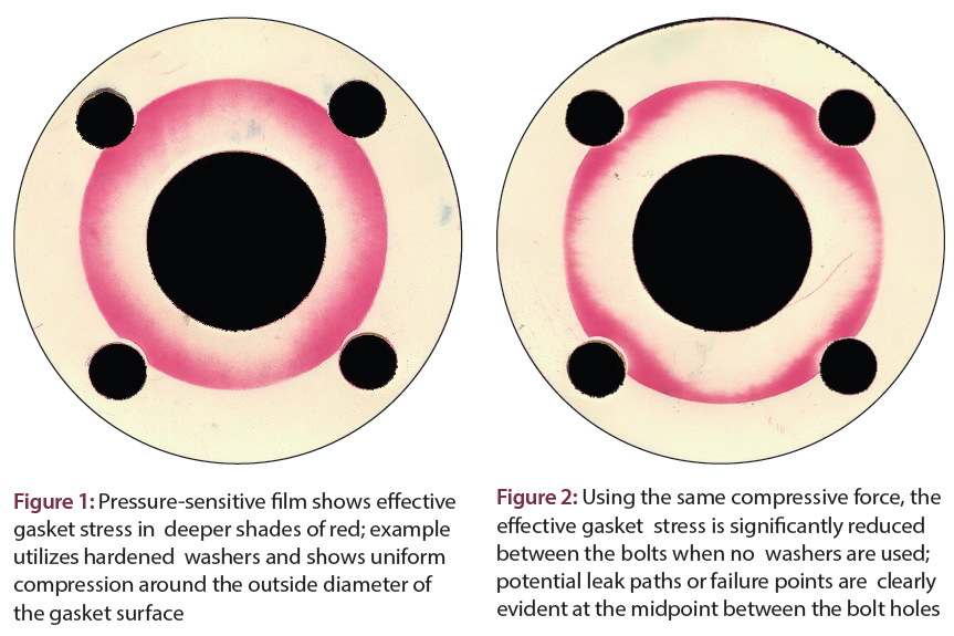

Figure 1: Pressure-sensitive film shows effective gasket stress in deeper shades of red; example utilizes hardened washers and shows uniform compression around the outside diameter of the gasket surface and Figure 2: Using the same compressive force, the effective gasket stress is significantly reduced between the bolts when no washers are used; potential leak paths or failure points are clearly evident at the midpoint between the bolt holes

2. Through-Hardened Washers
As amazing as it seems, the function of the washer may be the most important component in bolted flange joint reliability. Overcoming friction through turn of the nut procedures is critical in terms of realized bolt load. The interface between the nut and the washer becomes a crucial bearing surface.
If a washer is not through-hardened, it is also susceptible to cupping, resulting in inaccurate torque readings versus actual bolt stress. Another benefit of using through-hardened washers is the prevention of the nut becoming embedded against the flange face, or with a nut flat embedded inside the bolt hole. This will result in a large variable between applied torque and actual preload.
Utilizing through-hardened washers also disperses the applied load of the fastener assembly across the face of the flange. This allows for more uniform stress applied to the gasket contact area and reduces potential leak paths of the contained media.
