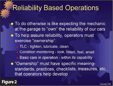

Moore explained that the maintenance organization is responsible for many functions, but it has no direct control over the successful outcome of these functions. For this reason, reliability success can only be achieved via an active partnership between maintenance and operations. Moore called this concept "Reliability Based Operations" as illustrated in Figure 2.
Fig 2
