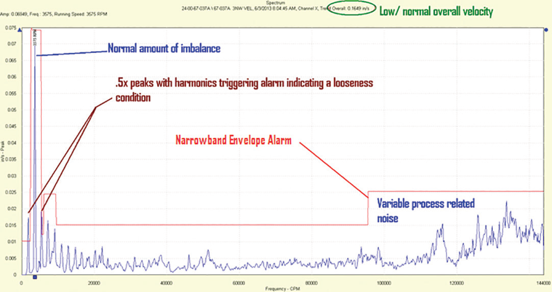

The first and one of the most valuable tools is the use of trend-based narrowband envelope alarming. Traditionally, plants used overall velocity to determine the condition of rotating equipment. Unfortunately, overall vibration could be affected by different situations, such as process conditions, machine load or location, mounting specifics and resonances unrelated to the machine itself. The alerting of an increase in overall vibration is an ineffective way to monitor machinery conditions. Spectra, time waveform, orbit plots, phase and other types of data have greatly improved the ability to identify the source and severity of the vibration instead of just the amplitude. Analyzing all this data takes a significant amount of time and when reacting to a possible fault condition, or trying to monitor thousands of components found at most facilities, there is much less time than there is data.

With narrowband envelope alarms applied to the spectra, CPChem's Sweeny facility can focus its efforts on reviewing data that has deviated from its previous condition, regardless of amplitude. The trended alarms are customized for each collection point based off a trend of its various running condition signatures. These variances allow elevation and dissention of specific frequencies, such as those caused by changes in process, accelerometer placement and even ambient temperature. More so, the alarms can be set to more stringent bandwidth and amplitude levels, giving the analyst an extremely early warning of the first leading indicator.
The software used makes setting the narrowband alarms easier than setting up overalls, so as conditions change and no fault is found, they easily can be arranged to allow for a recurrence of that condition. At the same time, when a fault condition is discovered, the narrowband alarms can be set to flag any leading indicators found in the historical data. Constant updates to the signature alarms ensure the same situation never repeats itself. When specific frequencies breach the envelope alarm, the analyst is directed to the exact frequency of concern, reducing the amount of time it takes to diagnose the issue. The longer the alarms are in service, the more accurate and reliable they become.
With accurate alarms set to catch leading indicators, the majority of CPChem's vibration issues are detected and resolved before a mechanical fault occurs and without the need to shut the machine down. The alarms also allow more time to plan in situations that require a shutdown, reducing the frequency in which the data needs to be collected and the amount of points from which the data needs to be collected. Any machine that is outside of its normal running condition is added to an exception route. The exception route is collected more frequently and additional points are collected on that machine, giving better details of the situation. With less data to analyze, more focus can be put on the items that need it. With the use of trend-based narrowband envelope alarms, data collection has been reduced by over 80 percent and machinery saves have increased immensely.
Figure 1: Narrowband envelope alarms trigger alerts for higher amplitudes at specific frequencies and allow higher amplitudes at others. Each alarm is customizable to specific points, allowing for variances in accelerometer placement and non-fault related conditions.
