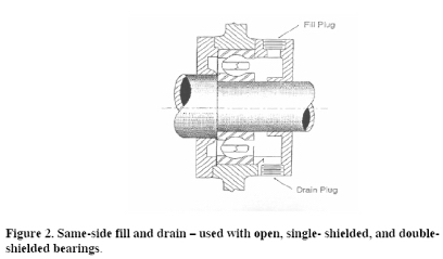

There are two basic bearing housing designs used in most motors with regreasable rolling element bearings.
Figure ! - Flow-Through Design - Used only with open face bearings.Figure ! - Flow-Through Design - Used only with open face bearings.
Same-siade fill and drain - used with open, single -shielded, and double-shielded bearingsSame-siade fill and drain - used with open, single -shielded, and double-shielded bearings
More motors are manufactured with a same-side design (Figure 2) rather than a flow-through design (Figure 1). For both designs the drain plug is the only external path for the grease to exit the grease cavity.
NOTE: Figure 2 shows a single shielded bearing installed. The shield is placed toward the rotor to act as a second line of defense from filling the inside of the motor with grease during regreasing activities.
