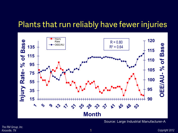

When a plant is reliable, there are fewer failures and process upsets, resulting in higher production capability as measured by asset utilization (AU) or overall equipment effectiveness (OEE). This reduces the exposure to the risk of injury. See Figure 1.
r1r1
Figure 1: Production capability (OEE) versus injury rate

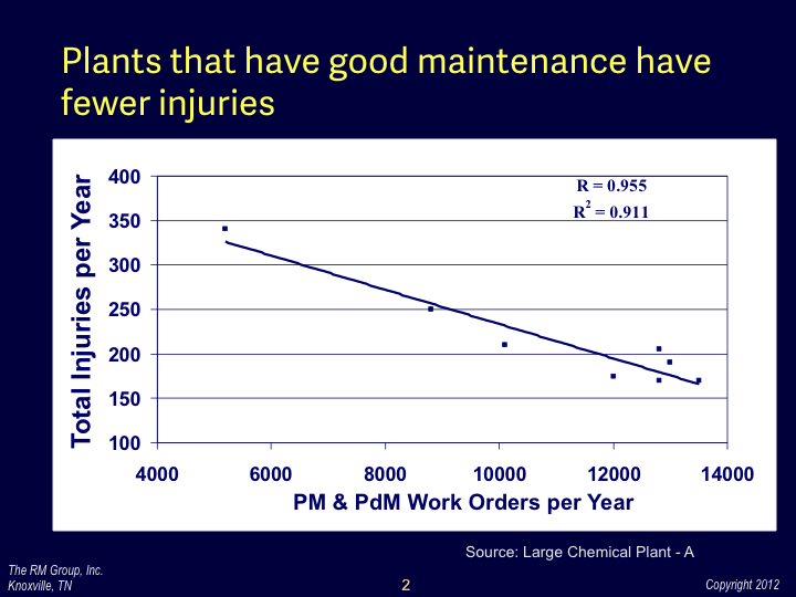

When plant equipment is cared for by doing preventive maintenance (PM) in a disciplined way, and when equipment is routinely monitored to detect problems early and those problems are managed by proper planning of the work, there are fewer injuries. See Figures 2 and 3.
slide2slide2
Figure 2: Injuries versus PM/PdM work orders per year
