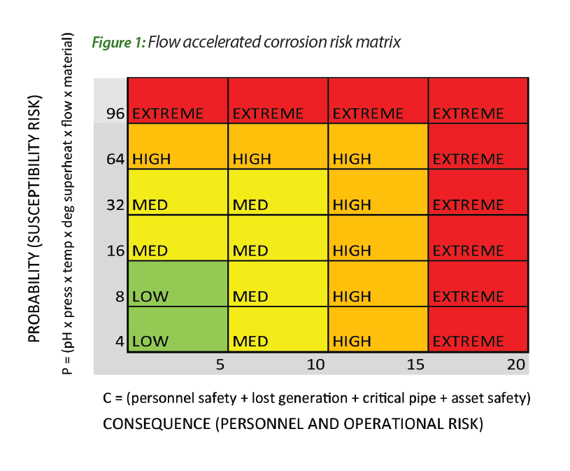

With limited resources and a mixed fleet of both legacy and new build power plants, it can be a challenge to keep up with the many inspection locations and data produced by a fleet flow accelerated corrosion (FAC) program. In addition, for those new to this realm of inspections, it can be intimidating to determine where to begin an inspection program, considering the thousands of possible locations from which to choose. To remedy this, a risk-based inspection approach that focuses on the highest impact areas first should be used. This approach leverages the risk grid, or risk matrix, where a composite score can be generated by using the formula: Risk = Probability x Consequence (R=PxC). This score subsequently can be used to determine where resources are to be focused on areas of highest probability of FAC and whose consequences could result in personnel injury, severe equipment damage and lost generation.

The next part of the equation is the consequence side of the calculation. The first consequence to think about is personnel safety. Once you have the lines selected based on susceptibility, walk them down and take pictures of each inspection location. Develop a communication package and schedule times to meet with the operators in the control room, the folks doing operator rounds and any seasoned veterans at your plant that have a good feel for what areas would be considered high traffic. Score these assessments accordingly using a numeric value. For example, you can assign a five for a high traffic area and a one for a low traffic area. Other locations to consider are those that are near workshops, restrooms, or any area where personnel may have a tendency to congregate. For those sites that are older and have asbestos insulation, an additional scoring category should be added to account for the increased risk to personnel.
The consequences of equipment damage should be considered next. While performing your walk down, think about what would happen if there was a steam leak or rupture in the area. Is there switchgear or other electronic equipment in the area? Give consideration to any equipment that, if damaged, would result in a unit trip or require a major maintenance outage to repair. Lastly, while discussing locations with the operators, ask what would happen to unit operations if a pipe rupture or leak occurred. Score the responses accordingly, for example, a one would be no effect to plant operation, whereas a three could be a unit derate and a five would be a unit trip.
Now you are ready to begin developing your risk grid and inspection scope list. An example of the risk grid can be viewed in Figure 1. In this example scoring has been applied to the various categories on the X and Y axis such that a composite risk score can be displayed. The grid is then broken down into areas based on low, medium, high and extreme risk. This information can be applied to the inspection scope list and risk ranking spreadsheet, an example of which can be viewed in Figure 2. As the scores are added to each proposed piping line, you can begin to see which lines pose the highest threat to safety and generation. This information is also great to have in the case of reductions in budget or outage scope. If either of these situations occurs, you will be armed with information to make a very good risk-based decision on where to draw your cut line. Be sure to add any inspection location that has been removed to your next year's plan.
In summary, this methodology can be used to focus resources and budgets while reducing risk to safety and generation for your generating fleet. It provides a framework by which piping lines can be evaluated using various sources of data and institutional knowledge. It also offers an organized approach to collating and displaying data for discussion meetings where budgets will be allocated towards future inspections. Lastly, it offers a visual method to display the information graphically so that program managers and inspection leads can quickly show high risk and high impact areas to managers, facilitating data driven decision making and reducing risk exposure to flow accelerated corrosion related piping failures.
