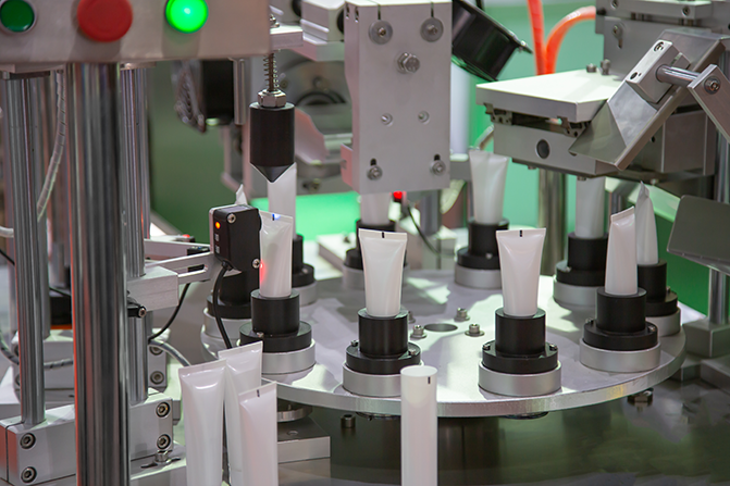

Bob and the CEO finally reached the area where the toothpaste tubes were fed into the boxes and the CEO could see two pieces of plastic tie wrapped around the feeding chute.
"When we got here, Joe noticed that every now and then a tube wouldn't enter the package and so he started to take stuff apart. He seemed happy when he told me the problem was really a simple one yet at the same time one that wouldn't go away. He said the feeding chain for the boxes stretches as it gets used and that's normal. The problem is when it stretches to the point of not quite lining up with the chute. The chain still has plenty of life though, so he put those pieces of plastic there so the tube wouldn't fall over and would find its way into the box!"
