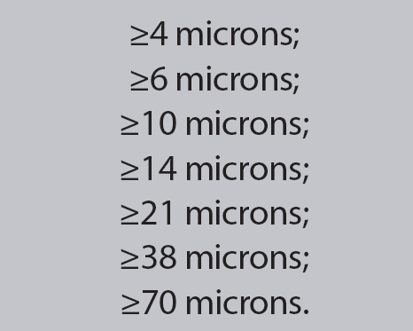

Particle counters are delicate instruments and their precise performance can be a challenge to maintain. Accordingly, frequent and careful calibration is necessary to validate the instruments' continued accuracy. Automatic optical particle counting calibration follows an established standard, which is ISO11171. This standard dictates that automatic particle counters are calibrated to accurately measure particles in accordance with the following values:
When reporting particles at the size ranges listed, it warrants noting that the particles measured at greater than or equal to four (≥ 4) microns include ALL particles four microns and greater in size. For the next level, ≥ 6 micron, only those particles five microns and less are excluded. Those particles that are six microns and greater are counted and reported. This holds true up the entire ISO calibration range.

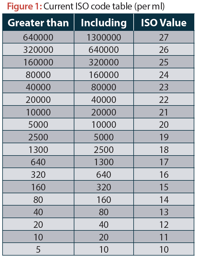

The reporting standard, as previously mentioned, is ISO4406:99. In accordance with this standard, the values used from the particle count data are related to the >4, >6 and >14 micron levels. The raw data at these micron levels are compared to a standard table and then translated to a code value. (Figure 1). By using the code, it is much easier to develop target values and report KPIs.
It's important to understand the concept behind the ISO code table, referred to as the Renard's series table. The maximum value of each level is approximately twice the value of the preceding level. This means the minimum value
of each level is also nearly double the minimum value of the preceding level.
This is accomplished by using the ISO code, which is a value that is an exponent of two, dividing that result by 100 and then doing a bit of rounding. Figure 2 shows the actual exponential calculations for each code value. This provides the maximum number of particles that a given code value can contain. For example, consider the code of 15.2 to the 15th power equals 32768. This value divided by 100 equals 327.68. For the purposes of simplicity, this value was rounded to 320. So, for any micron level with a code of 15, there will be a number of particles greater than 160 up to and including 320, as shown in Figure 1.
By following this method, it is easy to understand why the rule of thumb is: For every increase in an ISO code value, the possible number of particles doubles. At face value, it appears the code provides the user with a convenient grip on the nature of changes in the solid particulate concentrations in the oil.
There are some characteristics about the code that can create a false sense of security. For instance, due to the discrete range of values at each code level, the actual number of particles can increase significantly without ever registering a code change. At the same time, there also can be just a slight increase in raw data that causes the ISO code to increase, giving the appearance that the contaminant level has doubled. It also should be noted that an increase in nearly four times as many particles can result in an increase of only a single ISO code value.

Let's look at this proposition as it relates to the ISO code level of 20. In its current form, if the number of particles at a given micron size is greater than 5000 particles/ml up to and including 10,000 particles/ml, for that particle size, there is a range of 5000 and it is assigned a value of 20. If the range is divided by 10, there are 10 equal parts that have a 500 point value difference.
