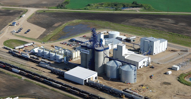

Richardson Oilseed is leveraging the benefits of the software. “We did not have a functional means of tracking equipment prior to implementing the reliability information management system. Any cost analysis or failure analysis was done manually using the work order history,” says Richard Pfeifer, maintenance planner at Richardson Oilseed’s canola processing facility in Yorkton, Saskatchewan.
The Winnipeg, Canada-based agribusiness has the majority of its process pumps and fans in the system, as well as specific process equipment, such as conveyors, bucket elevators, seed cleaning equipment, seed flaking equipment, seed presses, oil separator/centrifuges, hammer mills and pellet mills. A total of 283 assets are tracked.

Figure 2: Richardson Oilseed’s canola processing facility in Yorkton, Saskatchewan, is benefiting from reliability information management software.
