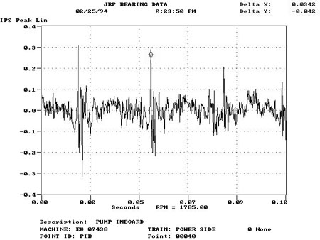

Fig 1
Knowledge of this relationship permits the determination of frequency components from the raw waveform data.
For example:
The above waveform was acquired from a 1785 RPM pump. The time spacing between the impacts is 0.0337 seconds. From this information the frequency can be determined.
f=1/p = 1/0.0337 = 29.67Hz = 1780CPM
This indicates that the impact is occurring at a frequency of 1 x RPM.
In most situations the time waveform pattern is very complex as illustrated below and therefore the determination of frequency components is extremely difficult using this method and is not recommended.
In most situations time waveform data is best utilized by applying the principles of pattern recognition and if necessary calculating the frequency components of the major events in the waveform pattern.
