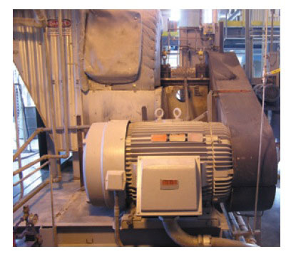

The fan was an AMCA Arrangement #9, see Figures 1 and 2. The fan and motor were mounted on a six-inch channel frame that was grouted using cementitious grout and anchor bolted to a concrete base. Vibration levels at the fan bearing housings, especially in the axial direction, were a concern. The axial vibration levels were high, but slightly different on each bearing. Both axial readings were in phase at running speed as determined by cross-channel phase readings. This vibration pattern is not typical for a belt drive. Most vibration was at the fan shaft rotational frequency. There was concern expressed about possible thrust loading generated by the fan and the potential effect on bearing life reduction.

The initial inspection of the fan identified movement between the fan frame and the concrete base. No loose bolting was found. Since the fan base was relatively tall, it would tend to be more responsive to the forces generated by unbalance of the overhung fan wheel, sheave run-out and belt vibration. These cyclic loads would be transferred from the bearings and bearing housings to the bearing support plate, the fan pedestal to the frame and then to the anchor bolts in the concrete. Secure attachment of the frame to the concrete and full support of the frame on the grout was important to prevent excessive frame flexure. As shown in the composite photo in Figure 3, there were only two anchor bolts clamping the frame to the concrete near the fan base. It was noted that the anchor bolts were not located close enough to the fan base to effectively restrain the frame and prevent flexure.
