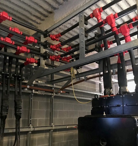

Figure 1: 480V secondary cables and transformer (Courtesy of www.impactaconsulting.com)

Incorrectly implemented or a complete lack of safety measures is an accident waiting to happen. The low complexity of the job or just plain luck is most likely why more injuries do not happen daily.
Not long ago, a contractor crew member got electrocuted inside a vault on a primary and secondary cable cutting operation to replace an end-of-life transformer. Following the incident, corporate requested to have active supervision from both ends of the de-energizing operation, one at the cutting switch and one at the vault, communicating via cell phones when the power was shut down and went back up.
When questioned, most crew members are aware of existing safety threats. They either are not aware of them or do not care too much about them. Transformers not properly locked out or tagged out are a typical example. When the crew lead was asked what was inside the transformer, a straight answer was not forthcoming. It appeared this crew was more inclined to do mechanical repairs than electrical repairs on high voltage equipment. The lack of knowledge of the surrounding conditions in the presence of existing, unidentified hazards was the perfect recipe for another Notre Dame incident.
