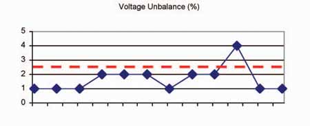

Figure 1. This maintenance control chart tracking voltage unbalance shows a Nov-03 reading above the 2.5 % limit and then the effect of the corrective action.

Voltage unbalance
In a three-phase system, significant differences in phase voltage indicate a problem with the system or a defect in a load.
• High voltage unbalance causes three-phase loads to draw excessive current and causes motors to deliver lower torque.
• Unbalance is tracked in percentages (see Figure 3). The negative sequence voltage (Vneg) and zero sequence voltage (Vzero) together identify any voltage asymmetry between phases.
• Using a power quality analyzer to do the math, high percentages indicate high unbalance. EN 50160 requires Vneg to be less than two percent.
