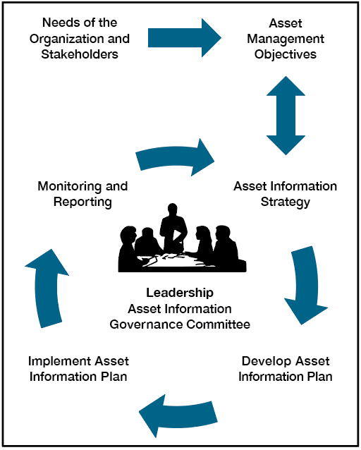

The most important ingredient for successful asset information governance is leadership. The critical roles of leadership are to create awareness of the importance of asset information for meeting business goals and to maintain the line of sight between asset information management and the needs of the organization.
Figure 1 shows a basic model for asset information governance. The model features these key steps:
  • The needs of the organization and its stakeholders are translated into asset management objectives.
  • An asset information strategy specifies the top-level approach to ensuring asset information will be effective to support the achievement of the asset management objectives.
  • Plans are developed and implemented to support the achievement of the asset information objectives.
  • Monitoring processes measure performance against the asset information objectives, informing the review of the asset information strategy.
  • An asset information governance committee, chaired by a senior executive and composed of asset management and information management subject matter experts, provides leadership and control of this process.
