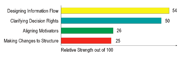

Supporting our arguments, an extensive study by Neilson et al. (2008) found that streamlined information flow and clear decision rights are the core requisites for successful strategy execution (Figure 2). We are convinced that this finding is also applicable to asset management. In fact, understanding information flow and decision rights may be significantly more valuable than directly engaging in structural changes and establishing incentives in the hope that they will invoke the required change.
part2part2
Figure 2: Building blocks of successful strategy execution.
