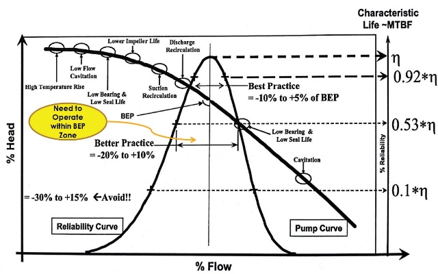

EXAMPLE 2 – Pump Performance Monitoring to Maximize Reliability Uptime % Out of BEP Zone
Centrifugal pumps account for the majority of rotating machinery in process plants. It is often observed that the centrifugal pumps are selected oversized to accommodate higher capacities. Fixed speed centrifugal pumps have a fixed best efficiency point (BEP) that coincides with delivering highest reliability. Continuous operation of a centrifugal pump far away from BEP affects pump performance and shortens pump life. Running multistage, high energy pumps <3000 kW at 30 percent BEP could reduce pump life by 50 percent.
part2part2
Figure 2: Pump curve vs. reliability curve
Utilizing process data from the data historian, a simple, automated tool can be developed that could effectively monitor the pump’s uptime percentage out of the BEP zone (i.e., 80 to 110 percent of BEP). If the plot shows the pump operated out of BEP zone most of the time, that would reduce pump life. Accordingly, the reliability engineer can take necessary mitigation action to bring the pump within the BEP zone for long-term reliable operation.
