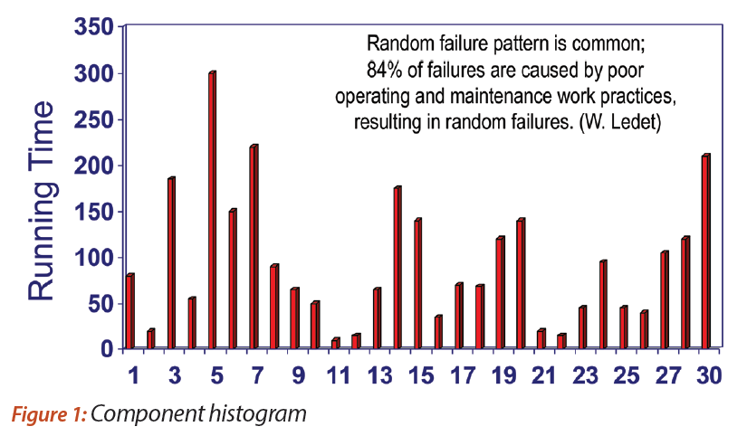

Example One. Mean time between failures (MTBF) is an often used term to characterize the average times between the failures in a given set of equipment. As demonstrated in the aforementioned example, it's also not particularly meaningful. For example, consider the data in Figure 1, in which 30 identical components were run to failure and then their life measured.
Fig 1Fig 1
Looking at the data, the MTBF is calculated as 90. It is further evident that about half the equipment fails before getting to 90 and the other half fails after 90. So, how useful is knowing that the MTBF is 90? If the MTBF is increasing or decreasing, that might be useful since you would know whether things are getting better or worse. But it's not particularly useful, for example, in setting preventive maintenance (PM) intervals. If you were to set up a replacement PM for these components and used MTBF for the replacement interval, you would be sorely mistaken. About half the equipment would fail before being replaced and the other half would have life remaining, resulting in a premature replacement. Neither is a desirable outcome.

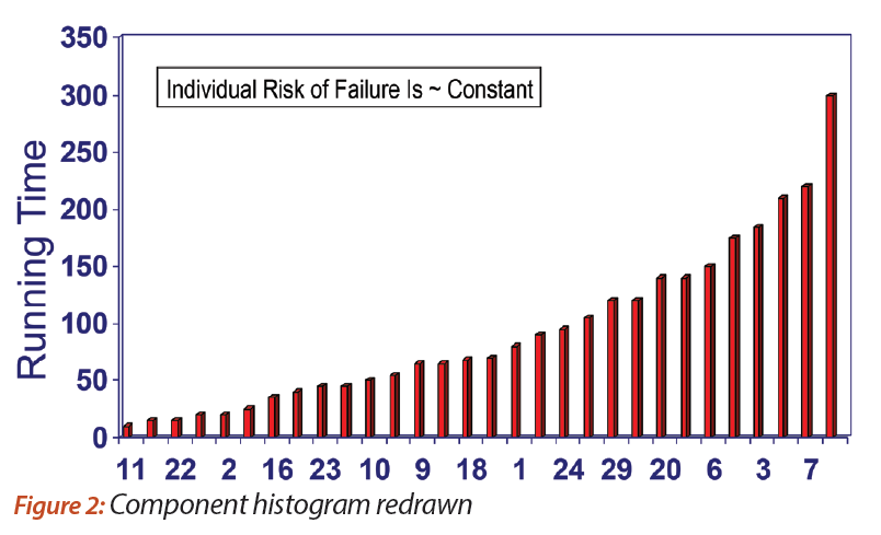

By reorganizing the data in order of shortest to longest life, the result is the Figure 2 graph.
Is this reorganization of the data useful? It's the same data, but now it shows that a failure occurs every five to 10 days, more or less. Would that be useful? Probably, since plans can be made for the parts needed and for when a certain percent of the equipment would be down and not available for production. How will you know which one of these components will fail next? After reflecting on this, you would likely conclude that you should do condition monitoring to detect which of the components has defects that would cause it to fail next. What sort of condition monitoring? That would depend on the failure modes associated with the equipment. How often? Well, something less than five to 10 days, so there is enough time to manage the consequence of the impending failure and to plan and schedule the work to mitigate the failure.
After a time, you would also try to be proactive and eliminate the defects that are causing the failure in the first place. At this point the MTBF would increase, but you would likely still have a random failure pattern. Some 80 to 90 percent of equipment failures are in a random pattern. Incidentally, according to Peter Todd, a Predictive Maintenance Expert with SIRF-Roundtables in Australia, Figures 1 and 2 represent an exponential failure rate and imply a constant conditional probability of failure. That is, the probability of survival, and of failure, of any given component is the same with a random failure pattern. According to reliability consultant Paul Barringer, this means there is a constant, instantaneous failure rate where the die-off rate is the same for any surviving or unfailing member of the population. That is, an old part is as good as a new part when you have a constant, conditional probability of failure. The way to manage a random failure pattern with a constant, conditional probability of failure is to use condition monitoring. MTBF, or average data, doesn't have much meaning in this situation, other than to let you know if things are getting better or worse.
