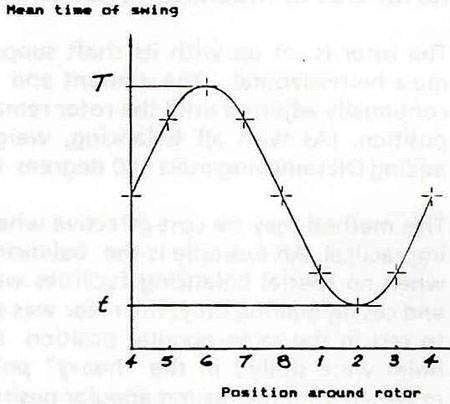

    • Mark numbers around the rotor, evenly spaced. For bladed rotors, mark at the blades.
    • Choose swing weight to fasten (by clamp or magnet) on rotor, to give to-and-fro oscillation time of about 20 seconds. (This gives some allowance for stopwatch reaction time).
    • With the swing weight fixed to rotor at Position 1, rotate the rotor so that the weight is at one horizontal position and stationary.
    • Release the weight and let the rotor swing freely under its own inertia -do not push it in any way.
    • Time the to-and-fro oscillation from the horizontal position.
    • Rotate the rotor so that the weight is at the horizontal position on the other side, and repeat.
    • Take the average time of swing for this position
    • Plot on a graph of time vs position (with position numbers evenly spaced: position 1 appears twice-at the start and the end of the position axis).
    Mean Time of SwingMean Time of Swing
    • Move swing weight to Position 2, etc. and repeat process.
    • Connect the graphed points with a smooth sine wave shape graph, and read off the maximum and minimum timed of swing: T and t.
    • Calculate the size of balance weight required from: - Balance weight = Swing weight ×
    • Check the result if required by repeating the swing test for 3 spaced points.
    • Make balance weight of the required mass, and fix it on the rotor at position of longest swing time. Allow for mass of weld.
    • If the correction is to be made by removing mass from the rotor, remove it from the position of quickest swing.
