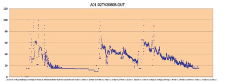

Figure 2 - Historical trend of the internal bypass valve position (electronic limit at 12%)

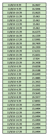

3.1.1. The first step, according to the proposed approach, was to collect the historical real time positioning of the internal bypass valve (discrete values each hour) at three different periods. (see Figure 3 example):
figure 3figure 3
Figure 3 - Example of discrete values for the internal bypass valve position

3.2.1. As shown in Figure 2, the final condition for the internal bypass valve is at its limit, so it doesn't represent any more physical degradation process. In order to estimate the remaining life expectancy for this system, another border condition was chosen (as limit), which was its output temperature, now expected to slowly but consistently increase (as no final control element is available at the present condition for the heat exchanger).
