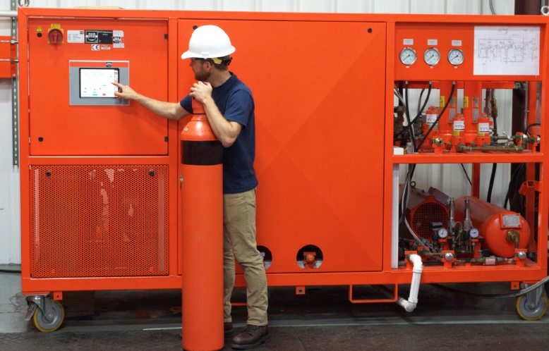

Figure 1: SF6 gas separator, which uses a cryogenic process to recondition contaminated SF6 gas to >99.99% purity.
