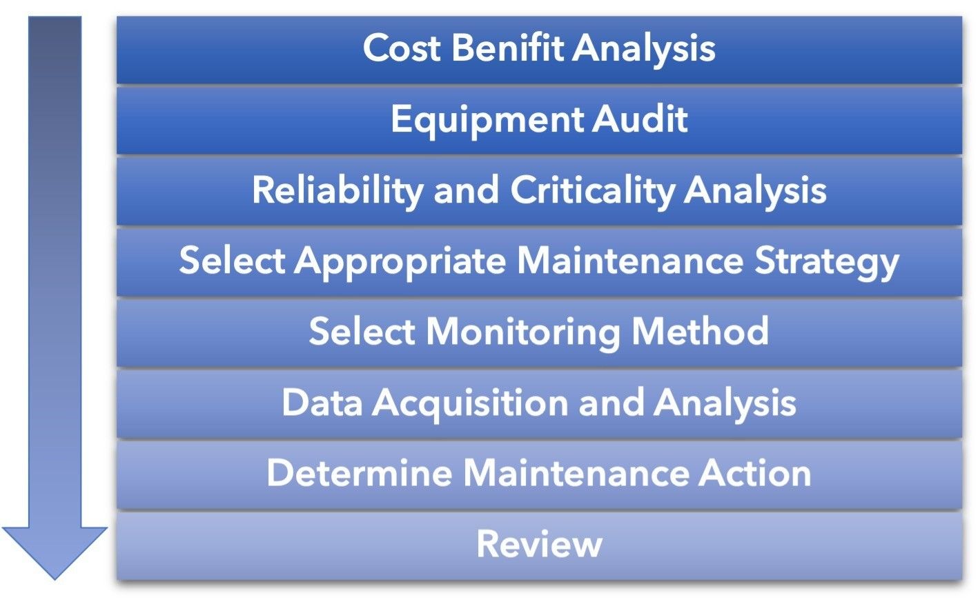

The International Organization for Standardization (ISO) has developed a generic standard procedure to be used when implementing a condition monitoring program [1], which encompasses various steps, such as cost benefit analysis, asset auditing, reliability analysis, monitoring method selection, data collection, diagnosis & prognosis, and maintenance decision-making (Figure 1). Adopting a standardized procedure for developing CBM strategy such as the one established by ISO can provide organizations with several benefits [2], adherence to industry best practices in the development of CBM strategies can ensure the flawless implementation of the maintenance program, thus enhancing asset performance and reducing maintenance costs.
Figure 1 : Condition monitoring generic procedure, ISO17359
