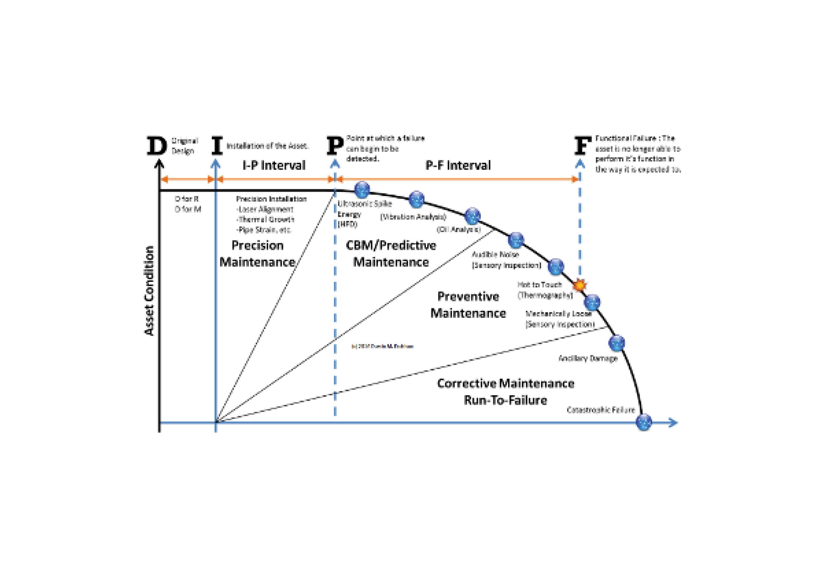

ACA results provide a clear judgment of a plant’s priorities, helping to achieve operations’ business goals. It is also designed to ensure that the most critical assets are operating in best-in-class (BIC) condition for a specific period of time. The aim is to extend the lifetime of an asset by applying the most suitable maintenance strategy based on the asset’s condition (Figure 1), whether a predictive maintenance (PdM), preventive maintenance (PM), or run to failure strategy. In general, ACA is a prioritization methodology intended to establish the most effective maintenance strategies for assets considering their importance and contribution to the plant’s business goals.
Figure 1: Maintenance strategies that can be applied based on criticality (Source: The Impact of Equipment Reliability on Human Safety, Production Technologies)
