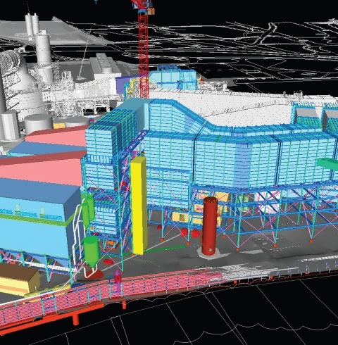

Future investments for environmental projects - Baghouses
