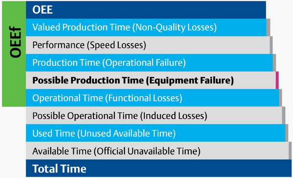

In 2005, Corbion began working toward its ultimate goals of 1.6 percent maintenance cost to RAV and 96 percent OEEf. OEEf is OEE plus issues in operations’ control, such as non-quality losses, speed losses, operational failure, equipment failure and functional losses. (Figure 2). Corbion’s starting points for OEEf and OEE were in the mid-70s to mid-60s, respectively, during the 2004 calendar year.
Figure 2: OEEf is comprised of OEE variables plus issues within operation’s control (non-quality losses, speed losses, operational failure, equipment failure, and functional losses)
