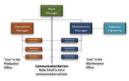

Figure 1 represents the typical organizational structure of a plant or factory. The plant manager is in charge. The operations manager reports to the plant manager and oversees the work of the operations supervisors. The maintenance manager also reports to the plant manager and oversees the work of the maintenance supervisors. Reliability engineering is, strangely, a dotted line connection to maintenance, which has always baffled me since reliability engineering is and always has been focused on assuring safe and effective production.
fig 1fig 1
Figure 1: The traditional plant management structure creates barriers to communication
Under the typical, functional organization structure, communication, apart from meetings which are usually formal gatherings, occurs via email. While email is a great way to convey facts, it's not a real form of communication. This organizational structure, while common and convenient from an administrative perspective, usually fails. It fails because it's functionally-focused, not value stream focused. Your value stream and the problems that interrupt it are cross-functional. If you hope to solve cross-functional problems, you need to organize accordingly.
