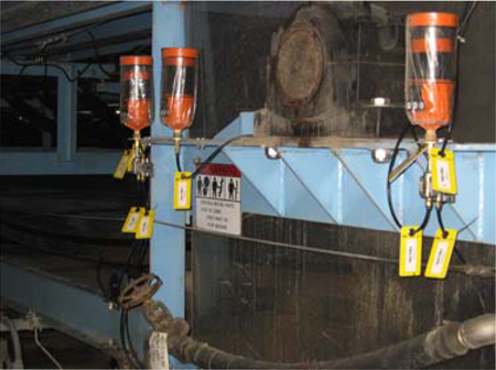

Every single lubrication point on every piece of equipment that will be lubricated must be identified and marked on either the equipment itself or within the Standard Operating Procedure/Work Task Outline. By referring to OEM manual guidelines , these tasks can be performed by a cross functional team within the maintenance and operations departments. The team can then survey the equipment to identify the lubrication points, photograph and tag them for the development of SOP.
Tagged EquipmentTagged Equipment
Tagged Equipment
