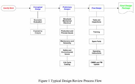

Review Process Flow
Design projects generally go through several reviews prior to issuing a final design package. A conceptual, several preliminaries and a final review are typically performed. The conceptual design may be used as a basis for an idea or in preparation for a capital budget request. Normally, there is only one conceptual design. Preliminary designs are the most numerous and time consuming depending on the complexity of the project. These preliminary reviews may or may not include all of the team members depending on the purpose. For example the reviews may be designated by discipline such as mechanical, structural or electrical designs. These reviews are decided at the kick-off meeting while assigning responsibilities for input. However, all of the team members shall participate in the final review process. Figure 1 shows a typical design review process flow.
Fig 1
