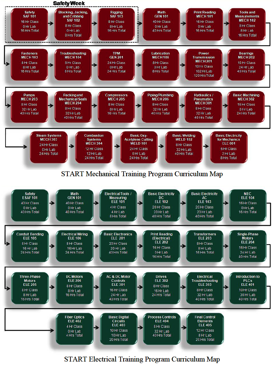

Solution Implementation The curriculum design focused on Mechanical and Electrical crafts. Working with existing materials and tailoring and customizing courseware GP set out to build an end-to-end program for the two craft areas that matched Shaw Industries’ unique needs and equipment concerns. Representative examples of the curriculum maps are included on the following page.
START Mechanical Training Program Curriculum MapSTART Mechanical Training Program Curriculum Map
In support of Shaw’s efforts to achieve a true blended learning approach, over 400 web-based training classes have been launched to further the abilities of the maintenance workforce when not in a formal class. These courses serve as requisite knowledge for a subject, but do not prohibit the employee from taking the instructor-led courses if desired.
