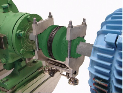

About 15 years ago, when I was teaching a reverse rim dial indicator course, I had an "Aha! Moment" about correcting horizontal misalignment. I had been teaching folks to calculate the horizontal misalignment at the feet and to place dial gauges at the feet to correct horizontal misalignment. People would often disturb the dials during the process, and the misalignment would need to be re-measured and re-calculated.
It dawned on me that if after sweeping the dials from 9:00 to 3:00, I could adjust the dials ½ of the way back toward zero, they could then be monitored as I moved the machine horizontally. The breakthrough came when I discovered that I could use the dial closest to the movable machine to monitor the front foot adjustment and the dial closest to the stationary machine to monitor the rear foot adjustment. I called this the near-near, far-far principal.
Verti-Zontal is Born
After I realized that dials could become true position sensors, it dawned on me that we are going about the correction process all wrong. If we can correct both the vertical and the horizontal axis with one set of data, we can save ourselves a lot of work and get better results. Most aligners realize that most of the work in the shaft alignment process is not in measuring, but rather in moving the machines into the correct position.
Imagine a completely different scenario:
1. Rotate the shafts. 2. Make a shim change. DO NOT tighten the bolts. 3. Use a live function to make a horizontal correction. 4. Tighten the bolts. 5. Rotate the shafts to remeasure. 6. Document final results. I call this process the Verti-Zontal compound move. Does this sound too good to be true? In fairness, it may take one additional Verti-Zontal compound move to achieve an acceptable alignment.

I'm pretty sure that the near-near, far-far idea is my original idea, because I've never seen anyone use the technique. By halving the dial values after 180 degrees of rotation, what I was doing was turning TIRs into what I now call true position.
A few years later, I had another epiphany while pondering the validity of the rule: if dials are set to zero and then read every 90 degrees, the sum of the vertical values will equal
the sum of the horizontal values.
Ergo, if dials are set to zero, rotated 180 degrees and then halved, they become true position sensors. The dials can then be rotated and will read true shaft position in whatever axis they are pointing.
