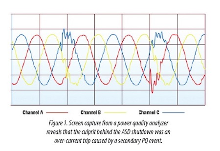

Located in an industrial park, a medium-sized manufacturing facility experienced the sudden shutdown of several adjustable speed drives (ASDs), an unanticipated event that wreaked havoc on key process equipment. At approximately 6:00 each morning, the utility-owned power factor capacitor kicked on to compensate for the inductive loads prevalent in many of the park's manufacturing facilities. The ASDs were conditioned to anticipate this scheduled power quality event and typically rode through the problem. So when one of the ASDs closed down and interrupted the continuous-stream manufacturing process, the facility manager needed to instantly find out why, correct the problem and prevent it from happening again.
Fig 1
As Figure 1 shows, a second, unanticipated capacitor-switching event occurred shortly after the first. This event was categorized by the facility's permanently installed power quality monitoring instrumentation which enabled the facility manager to pinpoint the exact source of the problem. Further analysis revealed that the ASD shutdown was the result of an over-current trip that was quickly remedied, thus preventing several hours of downtime, calculated at approximately $10,000 per hour.
