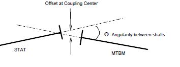

What is shaft alignment? Shaft alignment is the positioning of the rotational centers of 2 or more shafts such that they are co-linear when the machines are under normal operating conditions. Proper shaft alignment is not dictated by the TIR of the coupling hubs or the shafts, but rather by the proper centers of rotation of the shaft supporting members (the machine bearings).
Before discussing alignment tolerances, we should mention that there are actually two components of misalignment, Angular and Offset. Let's consider each of these separately.
Offset Misalignment, (sometimes referred to as Parallel Misalignment) is the distance between the shaft centers of rotation measured at the plane of power transmission from the driving unit to the driven unit. This is typically measured at the coupling center. The units for this measurement are Mils (where 1 Mil = 0.001").
Angular Misalignment, (sometimes referred to as "gap" or "face"), is actually the difference in the slope of one shaft, usually the moveable machine, as compared to slope of the shaft of the other machine, usually the stationary machine. The units for this measurement are comparable to the measurement of the slope of a roof, Rise/Run. In this case the rise is measured in Mils (1 Mil = 0.001"), and the run (distance along the shaft) is measured in inches, therefore the units for Angular Misalignment are Mils/1".

As stated above, there are two separate alignment conditions that require correction. There are also two planes of potential misalignment, the Horizontal Plane (the side to side) and the Vertical Plane (the up and down). Each alignment plane has offset and angular components, so there are actually 4 alignment parameters to be measured and corrected. They are Horizontal Angularity (HA), Horizontal Offset (HO), Vertical Angularity (VA) and Vertical Offset (VO).
