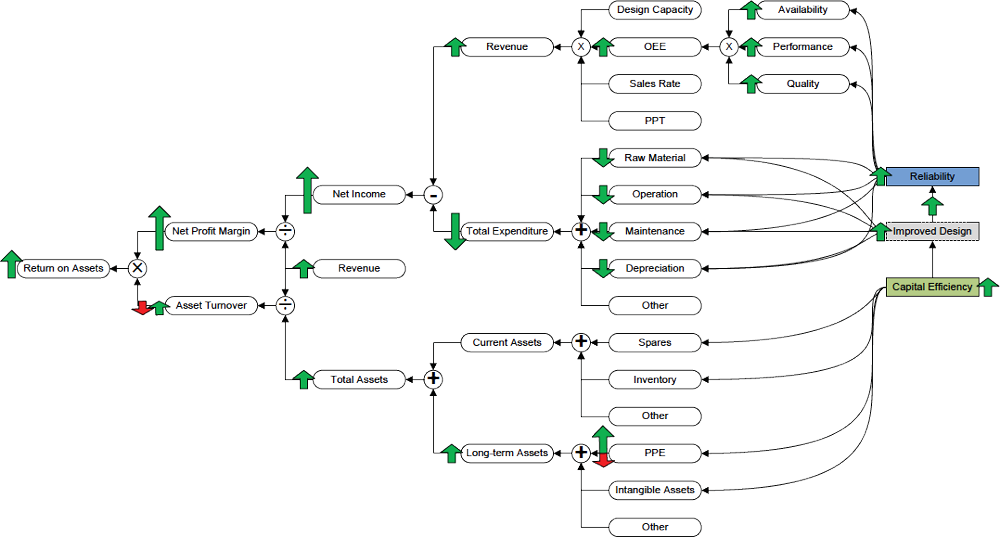

Spending capital on replacing an asset with low operational efficiency due to high expenditure can improve the ROA for an organization. High expenditures could be due to either poor inherent reliability, in which case both operational efficiency and asset use efficiency will be influenced if the asset is replaced, or expensive maintenance costs due to poor asset design.
Figure 16: Capital expenditures on asset replacement with lower overall expenditure
Figure 17: Capital expenditures on asset replacement with lower overall expenditure and improved reliability

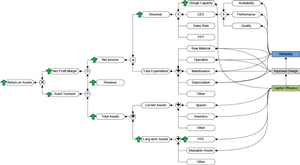

The ROA for an organization can be improved through increased production capacity as illustrated in Figure 18 by:
  • Enhancing the capacity of existing equipment.
  • Installing additional assets to add to the organization’s production capacity.
Figure 18: Capital expenditures to increase capacity to generate revenue
