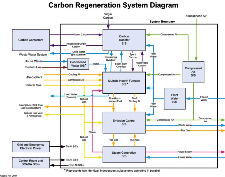

Because carbon regeneration is an extensive process, the team decided to focus on a manageable subsystem for the four-week pilot project. The team assembled a functional block diagram (Figure 2), which identifies the inputs and outputs of each of the six subsystems. The multiple hearth furnace, which is the most complex subsystem, was chosen. The system has two of these furnaces.

Spent carbon is pumped from the contactors as a slurry via the carbon transfer subsystem. This slurry then enters a carbon spent tank where it is metered into a dewatering screw. The dewatered slurry enters the top of the furnace and then proceeds through six brick oven hearths, guided by turning rabble arms affixed to a hollow, air-cooled center shaft. The bottom three hearths have natural gas burners – the hottest hearth reaches a temperature of 1600°F. The objective is to “bake-off” the impurities, not ignite them. The reactivation process takes 45 minutes. Upon leaving the furnace, the hot reactivated carbon is quenched in a water tank and then pumped back to the contactors. Additional components include a wide assortment of process control and protective instruments to ensure a safe, efficient and quality process.
