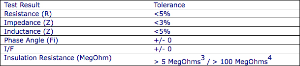

As a vast majority of the rotating machinery, that MCA is used to evaluate, requires balanced phases, pass fail criteria for individual readings can be developed for both assembled and disassembled machines (Reference Tables 1 and 2). These values indicate a guideline and values outside of these guides normally identify component failures that have occurred, or are developing. These developing issues can be compared against Attachment 1 of this paper.
In addition to the power of detecting a motor system defect, the values are trend able without the requirement of temperature adjustments for a majority of faults. This allows for the ability to evaluate condition and provide estimates for time to failure by monitoring changes to the phase to phase unbalances over time.
Table 1: Pass/Fail Considerations for Assembled Machines
Table 1 - Pass/Fail Considerations for Assembled MachinesTable 1 - Pass/Fail Considerations for Assembled Machines

For trending and analysis purposes, MCA is a comparative tool using percent unbalance and difference between tests methods. In the percent unbalance method, the difference between like coils (i.e.: between phases in a three phase motor) is trended over time. This method is best for resistance, impedance and inductance. While resistance values are impacted by temperature, for instance, the relative difference between phases is not. By using the percent unbalance method, the user or software do not have to rely upon performing temperature correction calculations. Impedance and inductance are not significantly impacted by temperature. Therefore, the unbalance method is the most convenient way of detecting faults over time. The difference between tests method is used for phase angle and I/F in which the lowest value for each is subtracted from the highest value for each.
