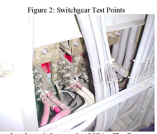

Figure 2 - Switchgear Test PointsFigure 2 - Switchgear Test Points
Testing was performed at the switchgear using MCA. The first set of data identified a problem in the circuit (Table 1). A second set of tests were performed in the connection box at the generator (Table 2) which identified both a winding short and poor insulation condition (unmatched Z and L).
