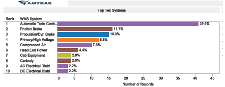

Until recently, tracking the number and duration of train delays attributed to a specific system had been Amtrak's only approach for routinely assessing equipment reliability. Figure 1 shows a typical representation of reliability performance, as expressed by the number of incidents attributed to each system of Amtrak's HHP-8 locomotive fleet of 16 units between December 11, 2013 and March 12, 2014. The graph shows that the automatic train control (ATC) system was the highest contributor to work orders generated by delay incidents, with 29.9 percent of the total.

        The graph intends to rank systems by reliability performance, with poorest performers on top. It suggests that resources and attention should be focused on the ATC system as an area with opportunities for improvement.
        However, it has been known for some time that this kind of representation lacks two basic notions of performance measurement: reference and causation.
        First, without a performance reference or base line, it is very difficult to qualify the actual performance level of any individual system. The inherent or achievable performance of any of those systems is missing in the analysis. Thus, the quantification of the potential improvementopportunity, represented by the gap between current and achievable performance, is not there to allow clear quantification of goals for an improvement effort.
        Secondly, without enough understanding of the causes for both achievable and current performances, it is very difficult to identify the areas that hold opportunities for improvement. The examination of the records represented in Figure 1 reveals that incidents associated with the ATC system contributed to 29.9 percent of delays. However, that number is not only comprised of what could be reasonably attributed to the system itself, but also includes effects of other systems' failures, debris damage, human error and other events.
