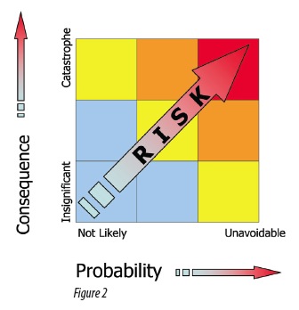

With differences in the FAC method, estimating this savings accurately lies in the use of a Risk Matrix to approximate the total risk for each failure avoidance case based on the conditions related to the failure and the criticality of thequipment. PdM early fault indicators can run the gamut from symptomatic (loose belt, looseness, unbalance) to problematic (defective bearing or gear) and the consequence can run from no effect to catastrophe, as shown in Figure 2.
By estimating the potential risk and assuming that there is a point P that occurs before point F on the P-F curve in Figure 1, failure avoidance costs can be estimated.
Probability and consequence define risk and are used to accurately determine the potential of the individual failure scenarios without having to resort to an all-or-nothing estimation method.
Consequence - Equipment/area specific information related to the range of severity of historical failures.
Probability - Potential for the event to occur based on the current conditions associated with the PdM monitoring results.

Risk Determination
The matrix in Figure 4 was constructed from historic failure data that showed increasing risk carries a higher cost. Low probability and low consequence events almost always result in a minor cost, while high consequence and high probability events almost always result in the highest costs.
The information from the sample case indicates a relatively "low" level of consequence because:
- the evolution of the failure is slow;
- the equipment is in a relative accessible area;
- the failure will likely be detected through noise generation prior to total failure.
Because the probability of this occurrence is inevitable once the failure mode is initiated and the damage to the bearing and shaft is irreversible, the probability of failure is determined to be "high."
Based on the low consequence and high probability, the total risk is estimated in the lower right hand corner of the risk matrix shown in Figure 4 and has this distribution of risk:
- In 30% of all historical failures with a similar risk profile, a minor failure occurs (emergency bearing replacement).
- In 60% of failures, moderate failure occurs (emergency bearing and shaft replacement).
- In 10% of failures, severe failure occurs (emergency bearing and shaft replacement and rotor/duct rework is required).
