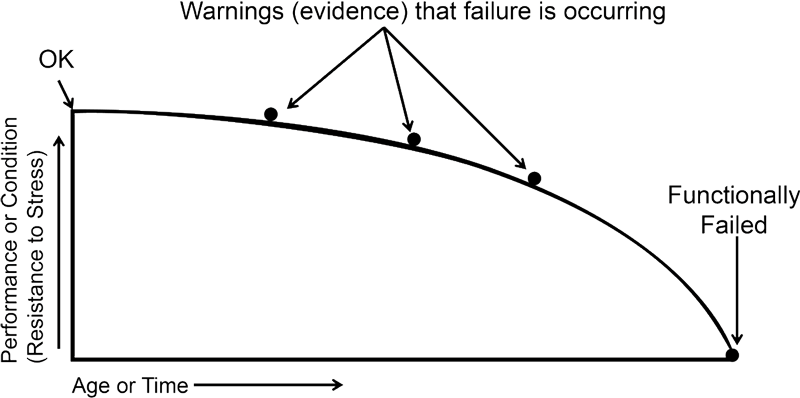

As the resistance to stress decreases, the component’s performance deteriorates. This deterioration sometimes can be detected through various means, as shown in Figure 6-1, an illustration of the failure process.
In the graph, the Y axis represents the condition or performance of whatever is being examined. This could represent an entire system, an automobile for example, or something as simple and discrete as an oil seal. Starting at the upper left side, the representation at this point is whatever you are looking at is new and thus, okay.
Figure 6-1: The failure process and evidence
As age or time progresses along the X axis, there will be warnings, including some that could be detected or observed if one were to look for them. These warnings or evidence that failure is occurring are what you want to describe in your failure effects. The best practice is to describe them chronologically in the order in which they would normally occur for the failure mode under review.
