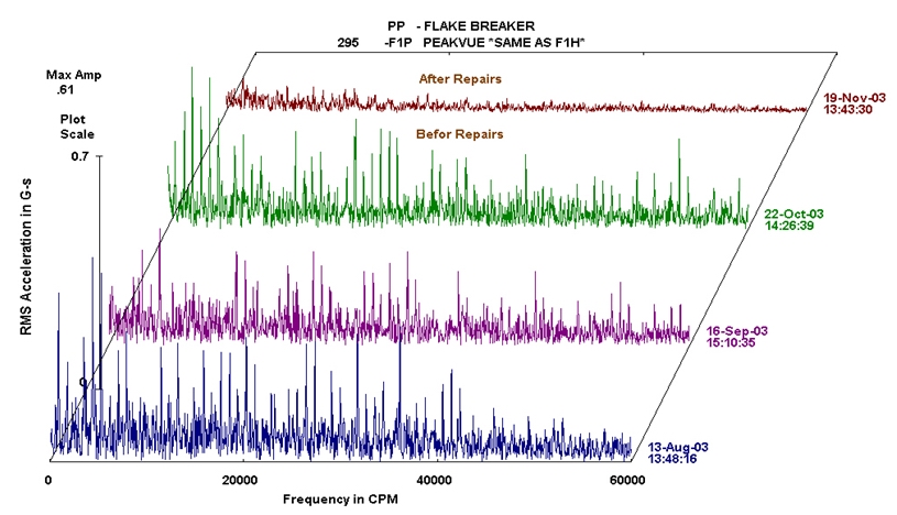

Route Data clearly shows the bearing defect in the spectrumRoute Data clearly shows the bearing defect in the spectrum
Route Data clearly shows the bearing defect in the spectrum. Bottom spectrum was taken after the Flake Breaker bearing where changed out.
Bearing Defect Impacting Occurring in the Peak Vue SpectrumBearing Defect Impacting Occurring in the Peak Vue Spectrum
Bearing Defect Impacting Occurring in the Peak Vue Spectrum. Top Spectrum was taken after the new bearings where installed. Impact has decreased.

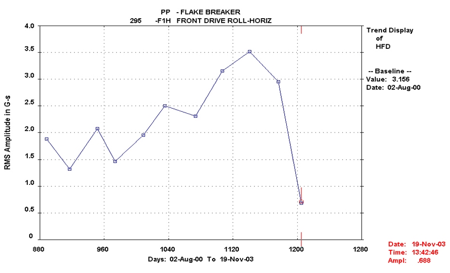

11 Months of Trend Data of the High Frequency Band11 Months of Trend Data of the High Frequency Band
11 Months of Trend Data of the High Frequency Band. Clearly show the rapid decrease after the bearing where replaced.
