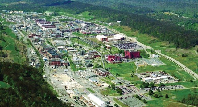

Figure 1 & 2: Aerial view and one of 300 facilities on the Y-12 site
