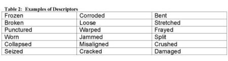

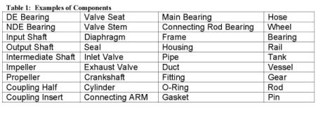

2.1.1. Failure Modes
Failure modes describe the individual failed components of the maintainable item, including a descriptor for what happened to the component. Failure modes are the things that occur and cause the system to lose its ability to produce its desired outputs.
Table 1Table 1
Table 2Table 2
2.1.2. Developing Failure Modes
Failure modes are best developed using an orderly system that includes a functional analysis of the equipment used in the process. Equipment is generally broken down into a hierarchy that shows graphically how the facility is put together to achieve its business output.
