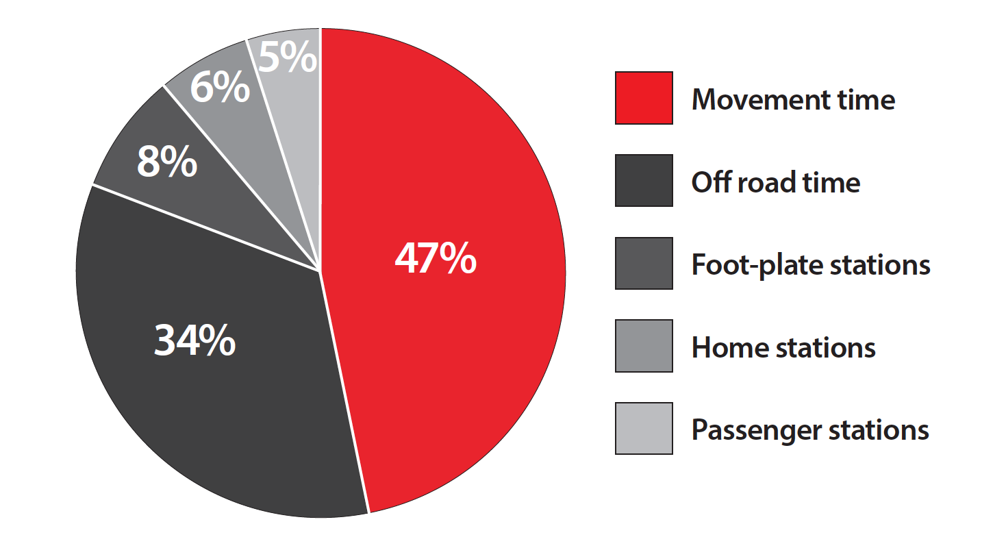

For example, for a Russian railway company, excessive off-road time for scheduled repairs, as well as running repairs and waiting for free repair facilities, led to the necessity to take out of service over 1,000 locomotives a day.3 It has been established empirically that a necessity exists in a locomotive that is ready for service 90 percent of its lifetime during the whole lifecycle.
Figure 1: Statistical locomotive time budget, 2016
