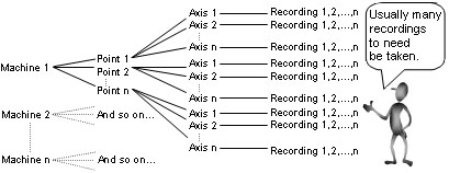

In most factories there are usually numerous critical machines that need to be monitored. Furthermore, to enable thorough analysis, each machine usually needs to be monitored at various points. Each point in turn often requires monitoring using different accelerometer orientations, and occasionally, using different measurement parameters as well. Thus, on every round of data collection a large number of recordings usually need to be taken.
