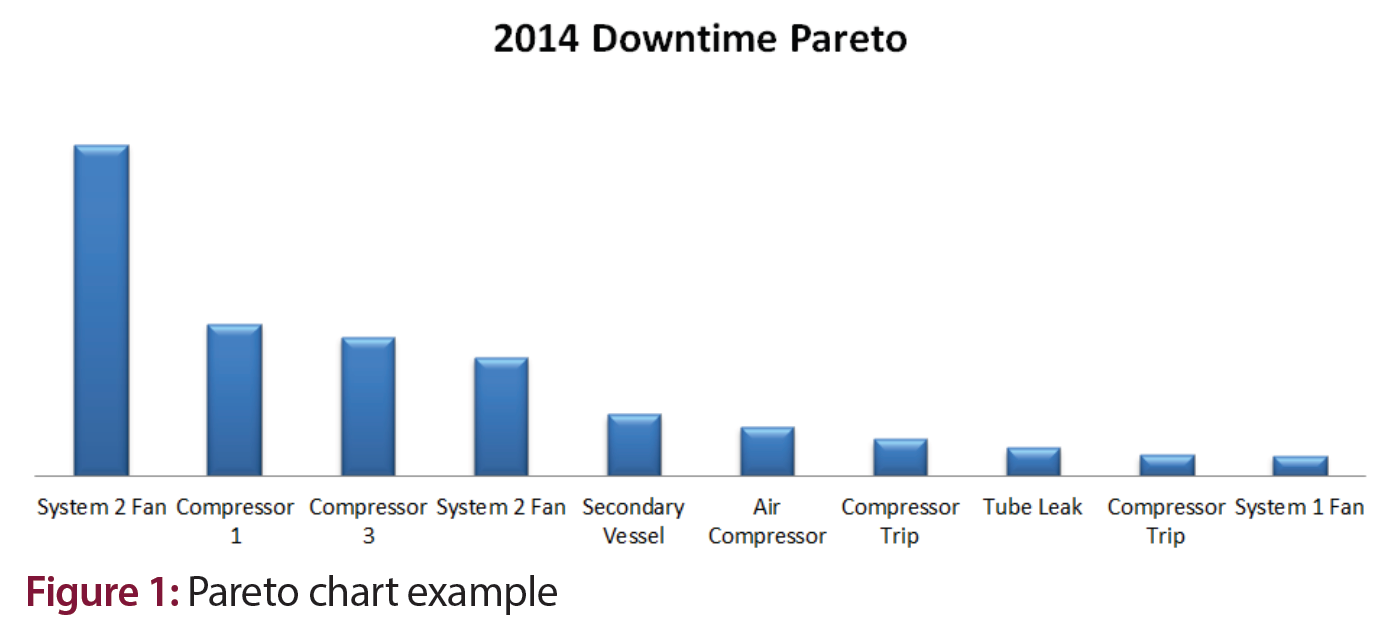

Pareto Bad Actors - Focus on Chronic Failures
The first step in our journey was to identify and focus on our chronic failures. In any improvement initiative, you have to know where "ground zero" is so you can develop a path forward. For us, it was simple, Pareto your downtime events and use the "80/20" rule. For those that don't know the 80/20 rule, it is based on the Pareto principle named after Italian economist Vilfredo Pareto. It means that 80 percent of your failures are usually caused by 20 percent of your equipment. The application of the Pareto principle in problem solving and analysis can provide a great starting point with simple data analysis of process, plant failure and production data. This will provide an early insight into problem causes and effects without intense or complex analysis. We need to understand what our 20 percent is in order to focus our efforts on the critical few that will have the greatest impact on the business. Do you know what your top 20 percent are?
Figure 1

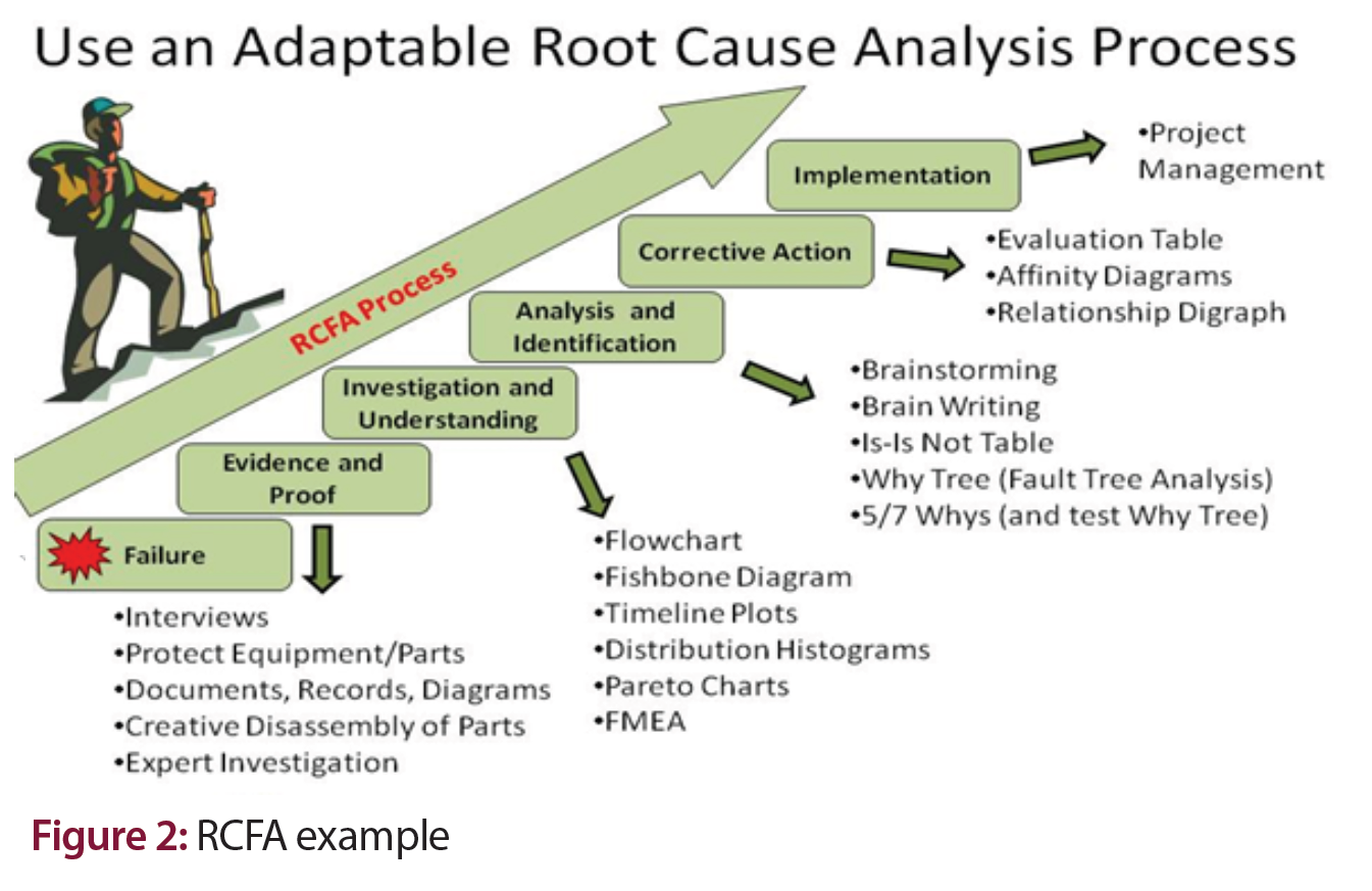

Apply RCFA and Measure Implementation of Recommendations
Once the Pareto analysis has been completed and we have identified our 20 percent, the next step was to conduct root cause failure analysis (RCFA). RCFA is a simple, yet disciplined process used to investigate, rectify and eliminate equipment failure, and it's most effective when directed at chronic failures. Your completed analysis is only as good as the person facilitating and the cross-functional team assigned to complete the engagement. Employee involvement is crucial in an effective RCFA analysis. You must have the right people on the team to complete the investigation and analysis. In order to understand and get the true value out of the RCFA, we must realize that most failures happen in three different layers. First are the physical component, human error and finally the latent root of the problem. The latter is always the true cause of the problem. Inevitably with most failures, there will always be some form of human error, whether someone failed to perform a task correctly, or missed a step in the process. Driving to the "true" root cause can be a challenge based on the dynamics of your operating culture. Again, the entire team has to be engaged and set the expectation that all failures are avoidable, and then work to foster a culture that takes root.
As the old saying goes, "what gets measured gets done," so it is true with RCFA recommendations. If you have experienced a repeat failure because you did not implement (in a timely manner) the recommendations of the analysis, then you understand what this adage means. Once the RCFA is completed and the recommendations are identified and prioritized, you must create an action log that has the task, as well as the owner responsible for ensuring the task recommendation is completed. Do not forget to put an expected date of completion beside the task as well. Once this is completed, set up a task review meeting to track progress. Include in your metrics the number of tasks completed, along with the number of open tasks awaiting completion, and add that to your weekly review meeting. Remember, if it is true that "what gets measured gets done," then you have created an avenue to improve the situation.
Figure 2
