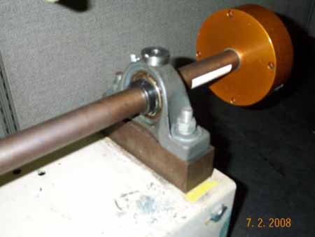

Fig. 2Fig. 2
Fig. 2 Photo of bearing assembly
Figure 1 shows the bearing of interest. It has been running for over 30 minutes; well past the standard 20 minute NOP (Normal Operating Temperature).
The apparent temperature at the bearing is an acceptable 126.2°F.

You can see the possibility of this condition in Fig#3
Fig 3
Just "1" stroke of the grease gun was all it took to take this perfectly normal happy bearing into the realm of potential failure.
One stroke of the grease gun was introduced into the bearing after a 30 minute warm-up run.
Almost immediately, the apparent temperature increased from 126.2°F to 130.1°F.
Every minute until a 10 minute period elapsed, the apparent temperature increased until it stabilized at 182.8°F.
After viewing the thermogram, we can see a simple procedure such as greasing a bearing is not so simple, who knew?
