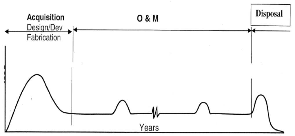

Asset life has three major stages, as shown in Figure 1.
  1. Acquisition - Designing, building and installing;
  2. Utilization – Operations and maintenance (O&M)
  3. Disposal – Decommissioning and disposing
Figure 1: An asset's lifecycle.
After a need/concept has been established, the acquisition phase starts. The acquisition phase includes writing specifications, design and procurement of components or the asset, build/fabrication of the asset, and installation/commissioning of the asset for operation.
The asset might be procured already designed/built as an “off-the-shelf” item or designed and built per special specifications depending on the need.
Utilization is the key phase where the asset is operated and maintained for many years depending upon need, which may be 10, 20, 50, 80 years or more. This is the phase where you get the value from the asset.
Disposal, the asset’s last phase, is where it is decommissioned. The asset’s need is over and is either put in the warehouse for later use or disposed of safely.
Based on experience and several subject matter experts (SMEs), the estimated average cost for these phases as a percent of the TCO are:
  • Acquisition Phase – 22%, with a range of 15% to 30% based on off-the-shelf or unique design;
  • Utilization Phase (i.e., Value Delivery) – 73% O&M, with a range of 60% to 80% due to asset complexity;
  • Disposal – 5%, with a range of 3% to 10% due to asset complexity and environmental requirements.
