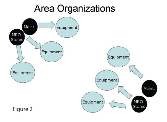

If the maintenance organization has an area configuration, then it is usually best to have the stores locations in an area configuration as well. Figure 2 highlights this configuration. In this figure, there is a larger geographical footprint for the plant or facility. It may actually be several miles from one side of the diagram to the other.
Given this condition, it makes sense to have MRO stores and maintenance co-located on opposite sides of the plant. This minimizes the travel time for maintenance to get to the equipment. Increased maintenance labor productivity is the result, whether it is in a proactive or a reactive environment.
The common complaint with using this type of a structure is the increased stocking levels for the MRO storeroom. In this configuration, it is true that there will be an increase in the stocking levels. This must be balanced against the increased maintenance labor productivity and the reduced downtime (and increased equipment capacity) that will be achieved by using this configuration.
