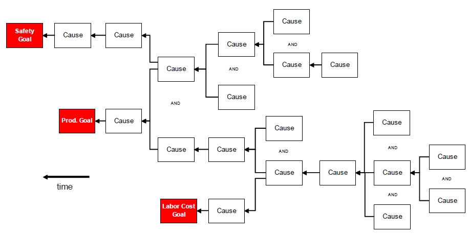

1. Cause Maps Read Left to Right
Since the traditional Japanese language reads right to left across a page, the fishbone starts with a problem on the right and builds across the page moving left. A Cause map starts on the left and reads right. At every point in both on the fishbone and Cause Map, investigators ask "why" questions that move backward through time, studying effects and finding their causes. This distinguishes the Cause Map from the process map, which moves forward through time with arrows pointing left to right (the process involves performing step one, then step two, etc.)

3. Cause Maps Focus on Cause-and-Effect, not Categories
An analysis breaks something down into its parts; analyzing an incident involves breaking it down into specific cause-and-effect relationships.
Fishbone diagrams group similar causes into categories: methods, machines, materials,etc. Categorization, however, creates generalizations-and represents a polar opposite of analysis. Grouping an incident's possible causes by category does not show the cause-and effectrelationships. In effect, a fishbone's categories simply create a "Yellow Pages" directory of causes-not a map that details how causes and effects relate. For instance, a training issue grouped under "people" can cause a person to make an error that results in an equipment failure, grouped under "machinery."
Specific details form the bedrock of any investigation, from the crime scene to machine maintenance issues on a plant floor, and a thorough analysis helps uncover those details. The Cause Map organizes these details visually into "effect" boxes on the left followed by a cause to its right; that cause, in turn, represents an effect of another cause, again placed to the right. (For this reason, everybox in a Cause Map can be viewed as both an effect and a cause at the same time.)
The fuel that drives the Cause-Map analysis involves "why" questions, which link together a chain of events. An investigator asks why an event occurred, and the answer will identify at least one cause of that effect; asking "why" that cause occurred turns that cause into an effect, and identifies further causes back up the chain of events.
The relationship between causes is more important than the category that the causes fit within. Just as a topographical map should reflect the actual terrain, a Cause Map should reflect the actual incident.

5. Cause Maps Focus on Systems Thinking
Which part of a car is required for the car to function: the engine, the transmission, the battery, the driver, the steering wheel, the tires, the brakes, or the fuel? They all are, of course, because all of these elements work as a system; remove one element, and the system doesn't operate the way it should. Considering how these systems relate to causes and effects requires systems thinking. It doesn't look for one answer, or the cause, but analyzes how elements and systems work together to create an incident. It also helps explain why there are so many disagreements when people try to identify "the cause" of an incident. In fact, most organizations only focus on a single cause and fail to see the incident as a system.
To illustrate systems thinking, consider one of the most devastating and technically complex incidents of the early 20th Century-the sinking of the Titanic. If you ask a group of people why the ship sank, you will likely receive various responses: the ship hit an iceberg; the ship filled with water; the steel was weak;or the ship was going too fast. Which one of the causes was required for the Titanic to sink? All of them were. Why? It is because the Titanic disaster occurred as a system.
A system requires all of its parts, just as an incident requires all of its causes. While many think of root cause as a single element in Cause Mapping, the actual root is, in fact, a system of causes. This systems approach shows that every effect has causes (plural), and it also allows any incident to be viewed more accurately at multiple levels of detail.
The more people focus on a single element that caused an incident, the more unnecessary disagreement, debate and argument can ensue. Unlike the fishbone diagram, Cause Mapping puts systems thinking front-and-center by clearly showing how systems of causes work together to create the problems that deviate from the organization's goals.
