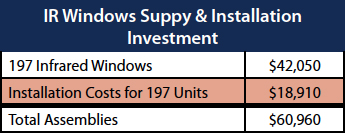

Investment
197 infrared inspection windows totaled $42,050.00. IRISS was also retained to supply an installation team to perform the installation of the IR windows. Installation costs sited in Table 2 were calculated using the following assumptions:
•Two-man installation team at $625.00 each per day (total cost $1,300 per day) x 10 Days = $13,000.00
•$30.00 per window installation charge x 197 Windows = $5,910.00
Table 2 - Total Costs
