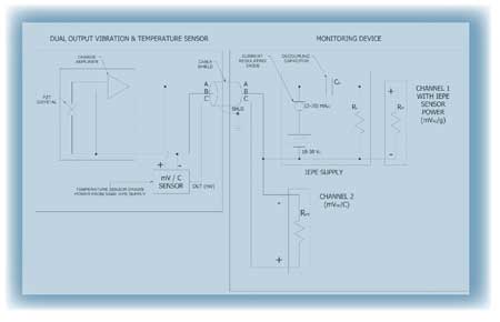

In the case of a dual output sensor that provides a vibration output (mV/g) and temperature output in centigrade (10 mV/°C), pins "A" (positive) and "B" (common) would require the typical integrated electronic piezoelectric (IEPE) sensor power on the vibration side of the sensor to create the acceleration output. Pins "C" (positive) and "B" (common) would provide a DC voltage output at 10 mV/°C for a typical range of approximately 0 to 120 degrees centigrade (Figure 1).
fig 1
Figure 1: Dual output circuit for vibration and temperature (centigrade)
